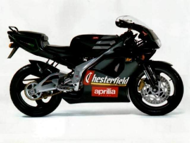

Make Model
Aprilia RS 250
Year
1998
Engine
Two stroke 90° V twin, liquid cooled
Capacity
249
Bore x Stroke 56 x 50.6 mm
Compression Ratio 13.2:1
Induction
2x 34mm Mikuni flat side carbs
Ignition / Starting
Max Power
72.5 hp 52.9 kW @ 11900 rpm (rear tyre 64.3 hp @ 10400 rpm)
Max Torque
40 Nm @ 10750 rpm
Transmission / Drive
6 Speed / chain
Front Suspension
40mm Inverted with adjustable rebound and compression damping. 120mm wheel travel.
Rear Suspension
Magnesium alloy swingarm. Monoshock with resevoir, adjustable extension, compression and spring preloading. 130mm wheel travel.
Front Brakes
2x 298mm discs 4 piston calipers
Rear Brakes
Single 220mm disc 2 piston caliper
Front Tyre
120/60-17
Rear Tyre
150/60-17
Dry-Weight
140 kg
Fuel Capacity
19.5 Litres
Consumption average
15.3 km/lit
Braking 60 - 0 / 100 - 0
12.8 m / 37.7 m
Standing ¼ Mile
12.2 sec / 174.3 km/h
Top Speed
206.8 km/h
