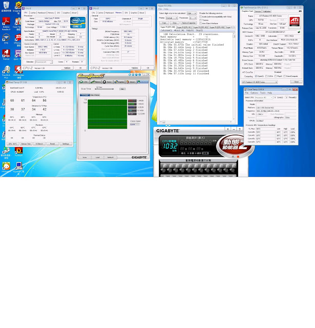

手動超頻5.0G 室溫32.1度,cpu最高溫67度
Koolance%252520CPU-370%2525E8%2525B6%252585%2525E9%2525A0%2525BB5.0G%2525E6%2525B0%2525B4%2525E5%252586%2525B7%2525E9%2525A0%2525AD%2525E6%2525BA%2525AB%2525E5%2525BA%2525A6%252520%2525E5%2525AE%2525A4%2525E6%2525BA%2525AB32.1%2525E5%2525BA%2525A6.jpg
備用卡4650燒FurMark1920*1080 8X 10分鐘
溫度都介於40~42度之間
