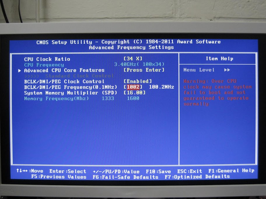

補充BIOS設定
Advanced CPU Core Features
Advanced Frequency Settings
Advanced Memory Serrings
Channel A(B) Timing Settings
Advanced Voltage Settings

Advanced Voltage Settings 跟OC5.1G設定差異只有電壓這一頁
